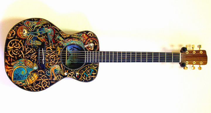

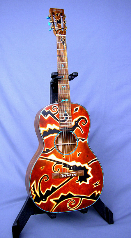

I've been good friends with Peter Cree for over 3 years now since he persuaded me to make a guitar for his Art Guitar project. Peter "paints" using pigments and nitro-cellulose lacquer, creating an acoustic finish as thin as any applied by the great hand builders and finishers. He has just finished a commision for C.F.Martin & Co on one of their 12 fret OO guitars based on the art of the Anasazi people of the American Southwest that will be unveiled by Martin next week at the NAMM Show in Austin, Texas. The guitar is fabulous:
Peter has a photo-documentary of the process on this guitar here on his website. Fascinating stuff.
This is what he did to the guitar I sent him 3 years ago:
PostPosted: Thu Jul 19, 2007 8:27 am
Neato!! Dave, on the first one, are the tuner buttons painted or is that turquoise?

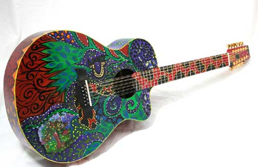

Dave, very cool. I had a local artist do the same thing. We both donated it to a charity auction and it was the highest bid piece there (even above the Jamacan vacations and such).
Here's mine:

Ron,
If you go to the link I posted it has all the details. The tuner buttons are turquoise as are most of the fingerboard inlays.

That's nice - I'd be interested in the technique your artist friend used. Peter doesn't just paint and then lacquer over it. This is how he describes it:
"The purpose of this work is to use a traditional and proven finish technique in a totally new way. By moving decoration onto the soundboard of a stringed instrument, I defy the notion that you can't decorate the top without compromising the sound. Adding pigment into the lacquer and applying with a brush, I sand flat and repeat until the image is built up and defined. This technique results in an ultra thin finish that rivals any other in volume and tone, while giving a dynamic visual presentation. Four years ago, after many years of experimentation, I began this project to show that an alternative to the traditional gloss, matte or sunburst finish can be accomplished. Now with this innovation, painting is possible on the soundboard. One can incorporate motifs from all cultures and any visual art design onto the surface of fine stringed instruments."

Faberge Guitars, so to speak!  Built up colors in thin layers.  Very interesting.

I really dig this... I would think though... if he is doing this with colored nitro don't you think he would get bleed from the melt in of subsequent coats of color, or even the coats of clear that go over it?
Any idea how he has conquered that problem. I have thought about doing this before.... Ever since I saw the modern Collings cowboy guitar I have had ideas like this.

Dave, I had written this guitar off as I really screwed up the lacquer on it. It was sitting on a shelf and donating it actually did me a favor as it gained some shop space.
The artist just painted this one. Looking at it closely, you see brush strokes and uneveness. I'm with MP in that I really don't like it as a guitar, but it's kind of a cool sculptural piece of art in its own right.
Sorry to dance all over your thread with posing of my painted "thing".

I have a well deserved reputation for liking my guitar wood to look as natural as possible, no tinted shellacs no pearl or abalone, no inlay of any sort and definitely no sunbursts or black tops!
But blow me I would love to own the guitar of Dave's that Peter Cree did his magic on. That transcends just being a guitar and has become something completely different.

First and foremost as a player of guitars, the tone has to be there. this is not paint but pigment mixed into small amounts of lacquer and brushed on. Far different than clearcoating or spraying. I can get my finishes to 2 mics with few brushmarks. The surface tension differs and there's little need to overcoat.
Its pure nitro that buffs flat.
Painting a guitar with an image is an endeavor that would make me ask "why". But working the "skin" of an instrument , a very important functioning element to a guitar, is the "art" here. Thus the project has been called Art and the Acoustic finish.
Sure many want to see the wood. I like to as well on many of my instruments.   But how many tan guitars are out there? There's room for something other than sunburst or gloss or matte. Especially if it performs so well.
So thanks for looking. Martin has been very good to me as has David. The resulting "Anasazi" is absolutely killer in sound. One of the best guitars I've heard. so check it out at Namm in Austin. any apprehension as to the technique will disappear.

I should also have said that this is the first guitar martin have made of "sustainable" woods. The top is 4 piece Adirondack spruce, the back/sides, fingerboard bridge and headplate are Chechen and the neck sustainable/certified Mahogany. This is what the Martin woodbuyer Linda Davis-Wallen says about Chechen:

Welcome to the forum Peter.  Very interesting technique and designs.  How DO you keep the colors from bleeding into each other when they touch? I think I saw that question in one of the other posts.

Thanks for the welcome and I take no offense. Fact is this work creates controversy and as the years pass I've gotten to a point of not being offended if someone like the work or not. I understand the love of wood since I've been a wood worker for over 30 years.
I've had no problem with control of the medium so no bleeding problems at all. The surface is so thin that theres never enough lacquer to bleed. The method is shown on my web-site. Just click on the Art guitars or on the Martin "Anasazi" pic. to get pics of how I do this.   A few "secrets" to the method but its basically add-on, sand to ghost, add-on, sand to ghost, add-on..........................ad nauseum.
This takes about 100 hours per top. Nuts really. but as a professional visual artist.................well, OCD has its advantages.
